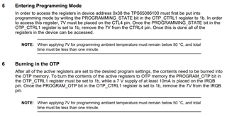

I’m using the PMIC – P/N: TPS65086470RSKT and I’m programming the second OTP memory according to my PMIC requirements.
My programmer set includes the following TI’s boards:
  • BOOSTXL-TPS650861 EVM
  • MSP430F5529 USB LaunchPad
I can program the second OTP memory successfully and I’m using the following software’s:
  • IPGUI 2.5.0.5
  • Adapter USB2ANY FW 2.7.0.0 - Device Description 1.1
My Windows version is Windows 10 Pro – Version 21H2
We have another site that use the same TPS65086470RSKT devices and has the same programmer boards and software’s, but it is using Windows 10 Pro – Version 2018.
The problem that this site can’t program the second OTP memory.
This site uses the IPGUI software and can use the Device Controls, Programing tab.
It can insert to Test mode and to Write (section (4)) and Check (section (5)) but when it wants to Program OTP (section (6)) it not succeeds.
  • Is there any limitation to Program OTP (section (6)) or any dependence of Windows version?

  • Hi Moshe,
    I'm not aware of any compatibility issues with Windows 10 versions. Can you share a screenshot of any errors you are seeing? Does the IPG-UI software display any red boxes in the top right that indicate programming has failed?
    You could try running the software in compatibility mode for Windows 8 to see if that changes anything, but if you can do all the other steps besides the last programming step (step 6), I wouldn't expect Windows to be the issue.

  • Thanks, James, for your support!
    We don’t have any red boxes in the top right only the pass blue boxes for both pass and fail cases.
    I’m using the transaction history report for the pass and fail cases.
    See the following fail case that the PROGRAM_OTP bit=1b (Addr:02 Data:A2) transaction is after GPIO_2 change to 0V (IRQB=3.3V and not 7V):
    2022-08-03T08:45:12.519Z Dir: W ProtoAddr: 38 RegAddr: 02 Data: A2 Seq: 200
                             Dir: W ProtoAddr: 38 RegAddr: 02 Data: See Below Seq: 200
    2022-08-03T08:45:12.480Z GPIO Write · · 0 · · · · · · · · · ·
    2022-08-03T08:45:11.650Z GPIO Read 1111100110110
    2022-08-03T08:45:11.610Z GPIO Write · · 1 · · · · · · · · · ·
    2022-08-03T08:45:11.610Z GPIO Config · · 1 · · · · · · · · · ·
    2022-08-03T08:45:11.565Z Control: (6), Action: program_otp, Value: None, Text Value None
    See the following pass case (My PC) that the PROGRAM_OTP bit=1b (Addr:02 Data:A2) transaction is before GPIO_2 change to 0V (IRQB=3.3V and not 7V) - as expected:
    2022-08-04T06:46:34.752Z GPIO Write · · 0 · · · · · · · · · ·
    2022-08-04T06:46:34.344Z Dir: W ProtoAddr: 38 RegAddr: 02 Data: A2 Seq: 199
                             Dir: W ProtoAddr: 38 RegAddr: 02 Data: See Below Seq: 199
    2022-08-04T06:46:33.969Z GPIO Read 1111100110110
    2022-08-04T06:46:33.950Z GPIO Write · · 1 · · · · · · · · · ·
    2022-08-04T06:46:33.950Z GPIO Config · · 1 · · · · · · · · · ·
    2022-08-04T06:46:33.927Z Control: (6), Action: program_otp, Value: None, Text Value None
    Enclosed please find both transaction history reports for the pass and fail cases.
    I can say that the set boards in the fail case used by me with Windows version is Windows 10 Pro – Version 21H2 and I didn’t see any program issues.
    It looks like the different between the pass and fail cases is Windows 10 versions.
