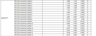

In the TPS65982 datasheet, there is many settings of  ILIMPP5V, but in the TPS6598x Application customization tool and the tps65982 Host Interface Technical  Reference Manual, I couldn't find the related interface register to adjust these settings.
How to adjust these settings following the table?

  • Hi Leon,
    These values are set up based on the PD contract and cannot be manually selected.

  • Hi Kevin,
    It's used in the charger adapter meaning as a source.
    When the Operating Current field in the sink Request Data Object is set to 2A, and the Maximum Operating current is set to 3A, does it's based on 2A or 3A?
    If don't use the PD contract,, only use advertisement mode: default, 1.5A  or 3A, does it automatically select the settings?

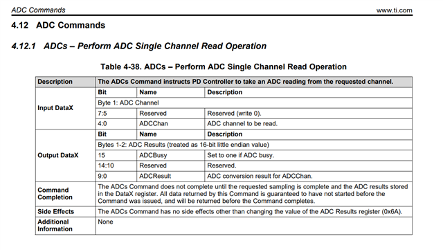

    I have another question, in the TPS65982 datasheet section 9.3.3.3, it indicates that  the current from PP_5V0 to VBUS is sensed through the switch and is available to be read digitally through the ADC, I can't find the registers of ADC to get the transformed ADC value..

  • Hi Leon,
    Thanks for the update!
    It will choose the maximum contract offered by the source that meets those requirements. The negotiations are done automatically.

  • Hi Kevin,
    Thank you for your reply.
    About another question, I didn't receive the answer.
    Thank you,
    Leon
  • Hi Leon,
    Sorry for the confusion!
    I meant to say that in the TRM attached above you can find this section about reading in an ADC value.
    It will be in section 4.12.
    I hope this helps!
    Thank you,
    Kevin
  • Hi Kevin,
    If the request current of PD contract is 3A, which setting will the TPS65982 select? Setting 14 or setting 15?
    Thank you,
    Leon
  • Hi Leon,
    I believe it should be setting 15 since it is the only setting whos minimum value is above 3 A.
    I am leaving this thread open and will reply back to you tomorrow once I confirm this!
