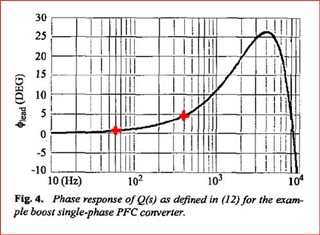

If you refer to these papers "On the Zero-Crossing Distortion in Single-Phase PFC Converter", Jian Sun, 2004 and "Demystifying Zero-Crossing Distortion in Single-phase PFC Converters", Jian Sun 2002, he shows that high current loop bandwidth alone cannot solve the zero-crossing distortion issue, but also requires the control loop to also be properly damped. I think he means, the phase margin of the control loop must be enough to prevent the control loop from oscillating as it transitions between DCM/non-conducting and CCM regions The 2002 paper clearly explains that a typical boost PFC stage has a leading current phase response, which worsens with higher line frequency. The issue is related to reverse biasing of the diode bridge which prevents the phase shifted PFC input current from pulling current continually throughout the cycle.

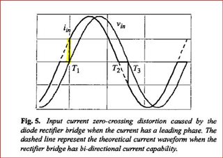

    First you need to sell yourself on the idea that the PFC stage by itself draws a current which leads the voltage by some angle which depends on the line frequency.
    This means that the PFC wants to draw a current ahead of the voltage, just by virtue of control loop theory – I’m waving my hands at this one. But the PFC is always (with the exception of a bridgeless PFC) precluded by a bridge rectifier. So, if the PFC wants to draw a current ahead of the voltage, this leads to a situation where the input voltage is still negative, but the PFC current wants to swing positive…but it can’t because the diode bridge is reverse biased (still conducting on the negative half of the voltage waveform.)
    So, then a dead zone appears where the PFC can simple not draw a current around the zero crossing. This is nothing to do with DCM, just diode bridge biasing and the inherent current-voltage phase relationship of a boost PFC stage. This dead zone is effectively unavoidable, and increases with increasing line frequency.
    When the voltage finally does swing positive the PFC will draw a high instantaneous current to get the current “back on track”. High di/dt – you can see this in the segment highlighted in yellow above. Various papers indicate that in order to limit the harmonic generation at this point, the PFC’s current control loop should be optimized to make this recovery without severe oscillation on the current waveform. Like any control loop, when the phase margin/stability margin is too low, (loop is underdamped), you get ringing on a step response. Current loop optimization is one aspect to improve this area.

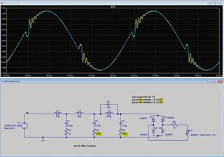

    So then why do we get a current spike when the X-caps are put in? I think this the input filter’s transient response to the “step current” which occurs due to the above diode bridge/phase phenomenon. The PFC pulls a current through the EMI filter (of course). Increase the di/dt or dv/dt on any reactive circuit, and  you are bound to get some amount of ringing, unless it is properly damped. EMI filters are usually not resistively damped because that generally degrades the effectiveness of the filter, forcing you to use a bigger or more expensive filter overall.
    In this case, I found that if we add some resistive damping to the X-caps, then the ringing response may be subdued. See below.
    **In our testing, as of today 8/30, this did help subdue some ringing at the zero crossing, but the peak amplitude of the zero-crossing distortion was not really reduced, so our issue still persists.
    Next we will try to remove one or more of X-caps and see if that will reduce the "transient peak" near the zero crossing.

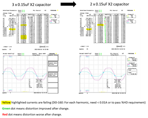

    Please see the attached example before and after comparison. Here we reduced the X-filter capacitance by 1/3 and the harmonic distortion is generally improved, except the 13th harmonic still fails by about 3mA. (10mA limit). We think the high di/dt "recovery" of the PFC stage, after the voltage zero-crossing, drives high current through the EMI filter which results in a "transient response" of components in the EMI filter. It is also not so practical to continue to reduce the X-cap capacitance, due to EMI concerns, of course.
    We will try some further experiments with UCC28180 ICOMP to see if we can reduce the "aggressiveness" of the control loop around the zero-crossing. Maybe we can improve the PFC's current response near the zero-crossing, smoother recovery of PFC current, less overshoot in EMI filter. Related to this idea, we ask for help on implementing a Type-II compensator on ICOMP. I think we will try something like this to see if it's helpful to improve the phase margin while maintaining good bandwidth.
