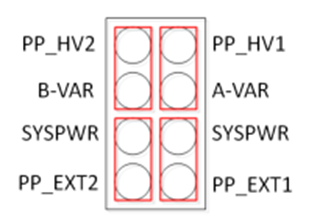

  • Hi Jack,
    Thanks for your patience!
    We do not recommend using the barrel jack to source power in the configuration you want.
    Instead, we recommending moving the jumpers on J11 to short the external power paths(PP_EXT1, 2) directly and disconnect them from System Power.
    Default Jumper Configuration(Red)
    New Jumper Configuration(Blue)
    You can use the jumper shorting the PP_EXT pins as your test point for sourcing power.
    If you want to directly monitor the port states and control the power path PFETs, you would need an external MCU communicating with the PD controller.
    For your use case, you shouldn’t need to do this. If both External power paths are closed and both ports are sinking power, the reverse current protection circuitry will open the PFETs on whichever path is supplying a lower voltage (i.e. If the variable contract is sinking 15V and the fixed sinking 9V, the PFETs on the 9V power path will be turned off), so only one battery will be sourcing to the PP_EXT jumper at a time.
    In regards to your use cases, within the GUI, make sure to (1) configure both ports as Sinks only and (2) make sure the desired contracts are being advertised on each port (your fixed 9V 2A and your variable 9->20V).

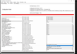

  • Hi Jack,
    Can you see what setting you have "Multiport Sink Policy" set to? If not already, try setting it to "Both sink paths will close switch". The setting should be under: Global System Configuration -> Multiport Sink Policy
    Thanks and Regards,
    Chris Lim
  • Hi Chris,
    Yes, this is the "Multiport Sink Policy" setting that I've been using by default. Though, I've also tried the "Only the highest power sink path closes switch" option with no difference in performance.
    I just noticed from you attached image, that you have a far newer release of the GUI (6.2.12 > 6.1.3); could I get my hands on that version/would that be useful in this situation?

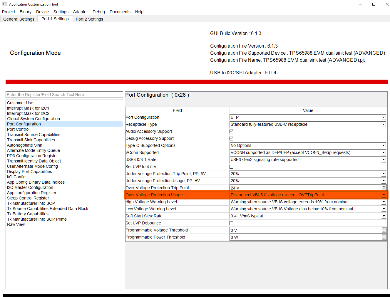

  • Hi Chris,
    I appears I've just cracked it!; two things:
    1 - Started an "Advance template" and set it up as per normal. After re-reading the TRM, I thought perhaps the OVP may've had something to do with keeping the remaining (in this case, lower power) PDO on Port-A open. So, I set it to "Disconnect VBUS if voltage exceeds OVPTripPoint".
    This alone didn't solve the issue as it still dropped going from high to low, however the SYSPWR bus did stay up for approximately 1/2second before rebooting the device.
    2 - I was poking around in the debug registers when I noticed that after clearing the "DBfg" (Dead Battery Flag Clear), the EVM no longer rebooted!!!!
    I've included a video of the hot-swap application working.
    Thank you for all your help so far; the only other question I have now is how to clear the [DBfg] automatically?
    Jack.

    I have successfully automatically sent the DBFG command with only the EVM, though use of the GUI's "Configuration Sets".
    I've attached a PDF document outlining the EVM setup as well as the project file, in case anybody comes looking here for the solution in the future.
    I'm moving this case to resolved, thank you for your patience and help with this.
