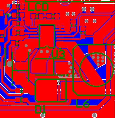

I used TPS61175 for step-up regulator. It should works with parameters as follows: Vin: 4V...7V, Vout= 11.5V, output current up to 1.5A. Coil presented on the schematic is MSS1038 - 15uH. Configured output voltage is Ok, but achieved efficiency is much less than expected. What is wrong and what should I do?

  • Is this testing on your own PCB or on the EVM?  It sounds like you may have a board layout that is causing noise to get into your circuit.  Could you post your layout?
    You could retest #2 by either a) connecting the device first, then applying power to the TPS61175, then enabling the TPS61175 or b) connecting the device first but keep it (your load) disabled until the TPS61175 is boosting to 10.5V.
  • It is my own PCB. The layout view below.
    Regarding to the second issue, I connected device after TPS61175 turning on.
    For now, I've tried to increase frequency and input/output capacitors, and converter managed to supply the device. However I would like to hear your suggestions.

    Referring to figure 18 in the datasheet, there are several things that could be better in your layout:
    1.  R18 is grounded to the PGND trace, not the AGND.  Cut the connection to the PGND pour and instead via that small AGND island and connect it only to the quiet ground above the IC.
    2. FB trace is too long and not grounded to AGND.  R14 needs to be close to R15 and R16 and the IC.  Just flip R16 over and ground it to AGND.
    3.  SW node is too large.  Also, the loop from PGND of the IC to the output cap to the diode back to SW is too large.  This is the most critical loop in a boost converter.  I'm not sure what component is between D1 and the IC, but it needs to move.  Lastly, it looks like there is a ground pour routed through that whole area.  This is bad as it couples nose into ground by adding capacitance to these switching nets.
    You can order the EVM, which has a good layout.
    I noticed a few things on your TPS62111 part of the circuit.  That IC needs at least a 10uF input cap, placed right at its input.  Not before any connectors or switches.  Also, if you're not using the PG function, then you can get rid of R19 and just float or ground the PG output.

    Two more questions:
    1) Where those GNDs should be connected (PGND to AGND) - under the thermal PAD ?.
    2) Why SW node is too large? What could it cause?
    KD
  • The AGND and PGND nets should be connected at the thermal pad ideally.
    The SW node is larger than it needs to be.  That makes it too large.  This node is switching between ground and Vout very fast.  There is a high dV/dt on it.  Since I=C * dV/dt, this will induce current in any nets that are capacitively coupled to it.  The bigger it is, the higher the coupling and the more current it can induce.  If this current is induced in sensitive parts of the circuit, it can cause issues.  A larger SW node also contributes to higher EMI and radiated emissions.
