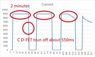

As the title, we set the mosfet on by using ALL_FETS_ON command, but after charging or discharging.
CHG and DSG MOSFET will turn off, but I cannot find reason.
This case happened on MCU firmware, didn't use BqStudio, we log all registers and flash memory for you checking.

  • Hi Matt,
    Init Mfg Config : FET_EN = 1.
    Before starting charging, send the command ALL_FETS_ON 0x0096.
    After charging for about 2 minutes, DDSG and DCHG will pull Low for 550ms, and there is no trigger protection at this time.
    Thanks.
    Benson

  • Hi Matt,
    When the problem occurs, REG1 is stable.
    I have tried setting the DDSG DCHG as a GPO and controlling it through the MCU, there will be no such problem.
    But I need BQ hardware to protect SCD and OCD, so I still need to set it to DDSG, DCHG.
    Thanks.
    Benson

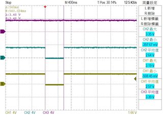

    CH1 DDSG, CH2 DCHG, CH3 REG1

  • Hi Matt,

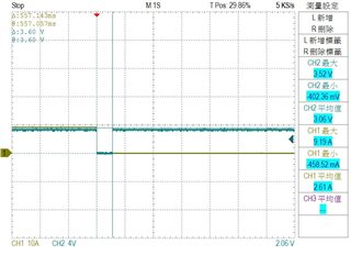

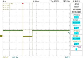

    My problem is that when it is set to DDSG DCHG, in the charging state, the charging interruption occurs every two minutes, at which time the DDSG DCHG will be turned off for about 550ms.
    I can't figure out why, and no protection has occurred, so I'm asking for help.
    Thanks & Best Regards,
    Benson

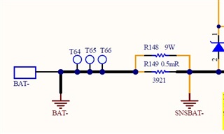

    What is your sense resistor value? Can you try to disable the SCD protection (or maybe disable all protections) to verify that this is not caused by a protection triggering?
    Matt

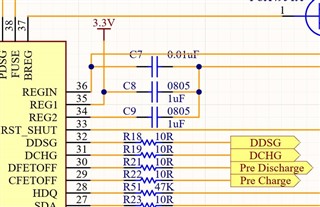

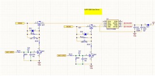

    I think the DCHG and DDSG pin settings are okay. I think they should try to set CHGPumpControl to 0 because I see in the schematic you sent that this pin is shorted to the BAT pin (no charge pump capacitor). Their FETs are configured in series, so the [SFET] bit should be set in the FET Options register.
    So FET Options should be set to 0x07.
    On the schematic, I also notice that the capacitor on the REGIN pin is 10nF. This is outside of the datasheet range - it should be 22nF.
    When they measure the waveforms, are they measuring the signals right at the DCHG and DDSG pins of the device? There are other circuits between these pins and the FET gates, so it would be good to confirm.

    Customer set FET options to 0x07, CHGPump set to 0 and changed the REGIN cap to 22nF, but it's not useful.
    And there has no other circuits between DCHG and DDSG of the device, DDSG connected to Q20 pin2 and DCHG connected to Q21 pin 2.

  • Hi Statham,
    I am testing now on my EVM with their settings. I cannot observe the same behavior - DCHG and DDSG are always enabled. Is it possible there are commands from their microcontroller that could explain the behavior? Can they disconnect the microcontroller to verify the behavior does not change?
    DCHG and DDSG should follow the CHG and DSG pins. The only difference is with the precharge and predischarge functions - this is explained in the Low Side FETs application report. DDSG combines the PDSG and DSG outputs (if either is asserted, PDSG is asserted) and PCHG combines the PCHG and CHG outputs.
    The only way to change the mode of the DDSG and DCHG outputs to general purpose output is to change the DCHG Pin Control and DDSG Pin Control register settings. They should not be changing register settings during normal operation though because FETs are disabled while in CONFIG_UPDATE mode.
    Matt
  • Hello Matt:
    DDSG and DCHG issues has been fixed, root cause is communication failed over 60 times, then MCU will re config SET_CFGUPDATE, then DDSG and DCHG will pull low by that processes.
