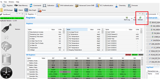

  • Hello  Wyatt,
    u meant to say click this refresh button
  • While clicking this one refreshing the register is happening

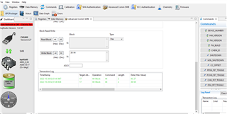

  • Hello Wyatt,
    Thanks for your updation , i have changed the setting and trying sending command while i am sending the command through advanced communication tab , EMSHUT bit is not setting in the operation status bit register .But through the inbuilt bqstudio comamnd EMSHUT bit is setting in operation status register but not turn off the bit setted for discharge and charge FET . Both dicharge and chage FET turned on.
    why it is not properly working in my case please help us.
    but still i have the communication with the BQstudio.Let me know what is the meaning of this  why the BQ studio communication not went off.?
    Why i am sending through command the bit is noty setting?
    How can i measure the emergency shutdown feature ? Could you please help me for further proceeding ?
    Please correct my command.

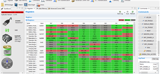

    ...mfc.gg.csv
  • added this screenshot also for your reference
  • Hello Mohan,
    You have the FET_EN bit cleared, this means the gauge will keep the FETs off unless you toggle them manually. I would enable FET_EN and configure the gauge so the FETs are on, then use the EMSHUT feature to disable the FETs. IF the FETs are already off the only way will be to see the EMSHUT bit. Otherwise you can check the DSG and CHG pins.
    I tested using your command sequence with FET_EN and EMSHUT works as expected using the advanced communication.
    Sincerely,
    Wyatt Keller
