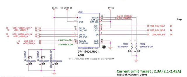

Hi team,
my customer plug in the mouse , and he have to wait 60s so it can wake it up in sleep mode (S3).
I know that's how our device works, and means the mouse probably the full-speed device.
but the strange things is they try it on the last platform which has same design same TPS2546 but with different CPU, the mouse doesn't have to wait 60s to wake up from sleep.
that's really strange..
any idea what this difference come from?

  • Hi Raymond,
    I think it's the same setting , since they only change CPU,
    they change from 1111 (S0)to 01111 (S3),
    this 60s thing , does it have anything to do with CPU?
    or just between TPS2546 and mouse?

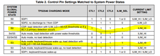

    The "status" (CTL 1,2,3 and ILIM_SEL pins) is all externally controlled by the CPU(?) which means any timing related to the status sequences comes from the CPU. Initial thoughts are that the routine is being handled at the CPU differently between versions. Because both generations use the same part and same status sequence, there only seems to be a difference in the timings which would point to the CPU.

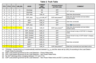

    [Q1] Can you describe what the customer expects the CPU to see from the TPS2546 in order to change the status. When will the CPU go from 0111 to 1111. Is there an internal timer that is waiting 60s, is it waiting for a signal from the TPS2546?
    [Q2] Is this handled differently in the previous version?
    Could you monitor the fault line, status line, and DM/DP out lines for the old and new versions, and see if they differ in value at all during these events. If you do no see any differences here then and there
    The TPS2546 part does not seem to have any recent updates so if the design and part is the same, the only thing that could be causing a difference is the CPU.
    Because we are starting in status 0111, the data lines are not connected and load detect is active. A requirement for Wake on USB is that the data lines are connected so this may be related to the delay in wake up.
