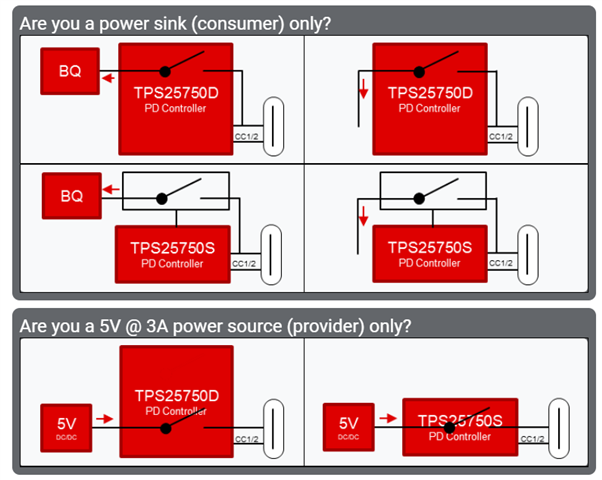

TPS25750: Completely turn off sink / source
Part Number: TPS25750
In this thread: TPS25750: Disabling Sinking or Sourcing (Revisited) - Interface forum - Interface - TI E2E support forums Chuck mentions
The Type C PD standard requires that a 5V PDO be provided if the device is configured as as DRP or a UFP, so there is no way to disable all sourcing unless you define the connection type as a SINK only.
I need to think about any method that we could use to force to device into sink only mode.  This would resolve the issue that you are seeing.
Have you found a way to achieve a way to truly turn off sink or source?
