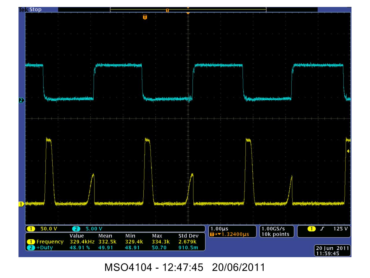

  • Below are a schematic and waveform plot for the circuit I have so far. The controller is staying in DCM through the whole output current range. However, the switching node waveform in yellow (junction of L1, U2 and D1) shows a second pulse. Do you know the cause of this? The FET gate drive is shown in the top trace (blue).
    Andy
  • Hi Andy,
    The second pulse on switching node is caused by the oscillation between the inductor and the parasitic capacitance at the switching node after inductor current depletes. It will induce switching loss when the FET is turned on. If you are fine with the efficiency, you don't need to worry about that. Same as the compensation design. The step-by-step design procedure given by the datasheet is just a guideline. If the converter already works for the whole load range and load transient response is acceptable, you don't have to follow the numbers given by the datasheet.

  • Hi Na,
    Thanks again for the feedback. Although efficiency isn't a deal breaker, it is always nice to improve it! Out of interest what could be done to reduce the oscillation? You said its due to parasitic capacitance, do you think PCB layout or component parasitics are the more likely culprit? Are there any datasheets/app notes that deal with this.
    Andy
  • Hi Andy,
    The parasitic capacitance is mainly the output capacitance of the MOSFET and junction capacitance of the diode.  What I can think of to reduce the oscillation is using snubber circuit. Simple RC snubber may help reduce the peak of the ringing but itself will dissipate some energy. If you are interested, the following is a very good reference on snubber circuit. Non-dissipative snubber may help the efficiency at the expense of circuit complexity and design effort.
