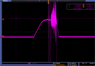

    1- FB Pin waveform
    2- RVCC with Load
    3- VCC with load
    4- HV Pin
    5- FB Pin 2nd waveform
    Please let me know if you need other pins waveform.
    You had mentioned that the device got damaged during conducted admission testing during trouble shooting.
    I had thought that maybe the TL431 feedback circuitry.  Since you changed the components on the TL431 circuit and the issue does not go away, this circuity most likely is not damaged. However, you might want to double check it's functionality with separate bias supplies without power applied to make sure it functions correctly.
    From your waveforms VCC is cycling between VCCSTARTSELF (26V) and VCCReStartJFet (9.65V).
    The FB pin starts from zero and soft starts to 5.6V and then shuts down.
    This could indicate an over voltage fault, over current fault or damage UCC256404 bias supply.
    Since your design was working you may have damaged the H Bridge FETs, ISNS resistor capacitors even the VCR divider capacitors.
    You may want to check them to see if they are O.K.

    1- FB Pin waveform
    2- RVCC with Load
    3- VCC with load
    4- HV Pin
