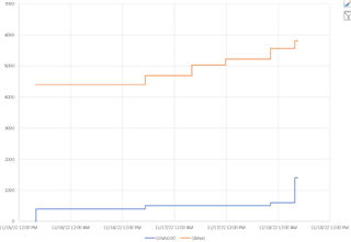

  • Yes, it takes many cycles to converge - you can see here the cells gradually going from a QMax of 4400 to almost 6000 when I'm targeting about 6800 (ignore the noise points - occasional errors over several days).  That's good information about if the LStatus is 0x04 there are no bounds, but I started this with a board freshly programmed with the 4.03 firmware bundle SREC.  I'll look more closely at the logs to see what the Update Status was at the point where it went from 4400 to its first estimate.
  • I graphed the LStatus as x*100 along with one of the QMax values, and it was indeed 4 at the first QMax update, at which point it changed to 5, then later to 6 and then 14.  Are there conditions other than LStatus==4 that determine whether there are are no bounds on the QMax update?
  • Hello Tony,
    I checked the source code and the Qmax boundary checks only apply after the Qmax is first learned, so I'm not sure why it is taking multiple steps for you. Can you share the .gg file from before and after learning along with the log file?

  • Hello Tony,
    Have you uploaded the best fitting chem ID using the GPCCHEM tool? If you have a badly matched chem ID it could lead to errors in Qmax calculation. From the logs it looks like your DOD0 is way out of the range it should be in (2^14 should be the max) Can you share the GPCCHEM report and the chem ID you're using?
    You can set the Qmax value closer to the design capacity, but you shouldn't need to, I think there is something else going on but I'm not sure of the origin at the moment.

  • Hello Tony,
    Yes I would try with one of the better fitting chem IDs and do the learning again, it should allow for a better Qmax update and gauging.
