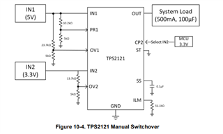

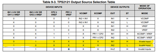

Hi Team,
We are analyzing TPS2121 Power priority mux source selection table. I have applied the Table 9.5 highlighted condition for 10.3 Example circuit and made the table. Please refer attached file. If Input 1 is in OV condition and Input 2 is in valid condition, as per priority table IN2 must be selected. For the same case, if PR1 is greater than CP2, then which input need to be selected?
