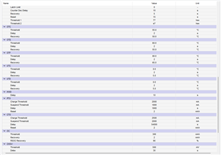

  • Hi Keller,
    Following are the settings done for temperature the FG.
    Following are the protection enabled.
    Following image captures the cell temperature and the mosfet states. it is observed that at 99deg C both the mosfets are still on even though my temperature settings are well below this temperature. This is same in case of charging and discharging.
    Are we missing anything here. Please help.
    Thanks and regards,
    Priyan George
  • Hello Priyan,
    The FETs are still on because you are in the FET test mode and have manually turned them on. The gauge will not control the FETs when you have FET_EN = 0. FET_EN must be set to 1 for the gauge to control the FET action.
    Also you must have the correct TempEn set. Please share your .gg file and log of tests.
    Sincerely,
    Wyatt Keller
  • Hi Keller,
    As i was unable to attach the .gg file, pasting it here for your reference.
    Priyan George

  • Hello Priyan,
    I am also having trouble changing the value under certain conditions, I think there might be a check in the FW for large jumps in temperature. Try changing the values slowly as I look into this more, see if it helps.
    Sincerely,
    Wyatt Keller
  • Hi Keller,
    Sure let me check by changing the temperature gradually. Also can you check if there is any miss match in settings in .gg file.
    Priyan George
  • Hello Priyan,
    I believe the root of the issue is because the value is filtered, so you will need to write to the register multiplied times before the filtered value settles.
    Sincerely,
    Wyatt Keller
  • Hi Keller,
    Which value are we talking about here. Is it the temperature value or is it some other register value?
    Thanks and regards,
    Priyan George
  • Hello Priyan,
    The user temperature sent to the gauge by the host. The input is filtered so you cannot write the temperature once and have the value trigger a protection because, for example, UTD protection uses the min of the cell temperatures and it is filtered. In normal operation the temperature will essentially be updated once per second.
    Sincerely,
    Wyatt Keller
  • Hi Keller,
    As you said we have enabled FET-EN to high and have increased temperature from 80 to 100 deg cel in steps of 1 in every 1 sec and we also tried it in steps of 1 in every 2 sec. Still Both FETS are not turning off. Can you let us know if any other reason is causing this or we have to check in any other way.
    Priyan george
  • Hello Priyan,
    I will take a closer look at this today.
    Sincerely,
    Wyatt Keller
  • Hello Priyan,
    Sorry for the delay, I did not have enough time yesterday. I'm checking with our SQM team if they have validation data from this firmware feature. According to the FW team this should essentially replace the temperature read by the gauge TS so it should work with both settings for USER_TS.
    Sincerely,
    Wyatt Keller
  • Hello Priyan,
    Wyatt is out of office today, he will reply when he gets back.
  • Hello Priyan,
    After digging through the code and asking around further it looks like you are testing with -R3 code, which does not apply the WriteTemp() value to protections, it is only used in the in the charge control temperature values. You must update your firmware to version -R4 in order to have the protections be enabled with USER_TS settings. This also requires a override key so it cannot be written erroneously.
    The two firmware versions (R3 and R4) implement this feature differently.
    Sincerely,
    Wyatt Keller
