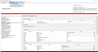

    It seems like you are trying to program the registers over I2C. I would recommend getting familiar with the general PD operations using the APP Config GUI and an EVM. Within the GUI, you can enable "Show Bitfield Ranges", which will display bit locations for the values. This may make it easier to (1) prototype certain configurations and (2) know which registers and bits need to change.

  • Hi Chris,
    We met a problem while trying to install the TI APP config GUI. so we still trying.

  • Hi Sofian,
    Is this the gui found on the TPS65987D project page?
    https://www.ti.com/product/TPS65987D
    Regarding your statement below, can you give more details like how to config in register offset 0x32 ? from the above registers bits.
    The easiest way would be to adjust the settings in the GUI and see the corresponding bits that change. The descriptions explain what the bits represent pretty well. Are there any specific ones that are confusing?
