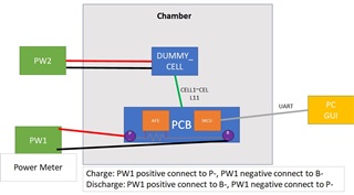

Hello Sir:
We had been tested our PCBA.
But we found the current measurement results was not good when 0 degree and -10 degree.
Please refer below block diagram and tested results.
Tested results

Would you please teach us how to improve the current measurement accuracy when 0 and -10 degree?
Looking forward your feedback.
