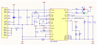

In this design, while testing, The PG LED is turned ON. However, the STAT LED is blinking at 1 HZ. While looking in the datasheet, multiple reasons are listed for this behaviour.
The input Voltage is 5.12 V. Battery Voltage is 7.23 V.
Here I am not using NTC and the voltage across the TS pin is around 4.1 V. Is not using an NTC an issue? What combination should I use for the voltage divider ignoring the NTC? or is there any other issue?
Note: R5 = 5.23 K, R8 is 30.1K. R7 is not populated.

    If an NTC thermistor is not used, the TS pin needs a voltage between the percentages below relative to REGN.  So set R5=R8.

    I have added the resistor accordingly and now, the voltage across the TS pin is 2.29V and the STAT LED is constantly ON now.
    However, the charging voltage is just 8.01V instead of 8.4V. What could be the possible reasons for drop-in charging voltage?
    Note: RSET = 150 K (R2)

    Found that this is again due to the resistor across TS pin. When I changed the R5 to 5.1K and R8 to 30K, the cut-off issue was solved. However, the STAT LED is keep on blinking (again due to TS Voltage) which is around 4.3 V.
    However when I use R5 = 5.1K, R8 to 30K and R7 (instead of NTC) to 4.7K, the issue is resolved. But the charging voltage is only 8.14V without battery and 8V with a battery. VREGN = 2.2V

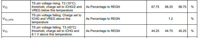

    This may be a stupid question (I am a newbie here) but according to the below table:
    The voltage across TS should be around 1.2% of VREGN (5.08 V) which is around 0.061 V. Am I correct? However, if R5 = R8, then the TS  voltage is around VREGN/2 (2.54 V) which is around 50% of VREGN. Dos this create any issues here?
    The TS voltage needs to be between VT2 and VT3 for full charge and charge current. Otherwise the restrictions shown in Figure 19 apply. The 1.2% you are referring to is hysteresis, not full value.

    Thanks. Now i have modified the resistor combination in such a way that the voltage across TS pin is 2.51V (49.4% of VREGN). But I noticed a different behaviour.
    When I connect the USB cable without Battery, the STAT LED blinks at 1 Hz. But if i plug in when the battery is connected, the PG LED blinks 5-6 times and turns off.
    I also have a few doubts, I have set the charging current to 2A (R-ICHRGSET 7.87K) and D+ and D- are shorted through a 100E resistor. And the input current limit resistor is 383 Ohms. Does this create any issues with charging?
    I have changed the R-ICHRGSET to 1K. Now the PG led works fine and STAT is also not blinking and is continuously ON. However, the voltage across the BATT pin when the battery is not connected is 8.5 V and when it is connected, it is 8 V and gradually increases in steps of 0.01 V for every 5 min and reaches 8.35 V within 40-45 min.
