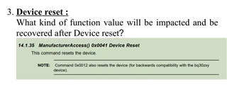

  • this question no result?
  • Hello xiaofu,
    Device reset will clear all RAM values, this means FCC, RemCap, SOC, etc will all be recalculated based on the voltage at that time we do a correlation for voltage to DOD based on the chem ID under the assumption the voltage is relaxed. Reset should never occur during normal operation of the gauge and can cause gauging issues depending on when it is sent.
    Sincerely,
    Wyatt Keller
