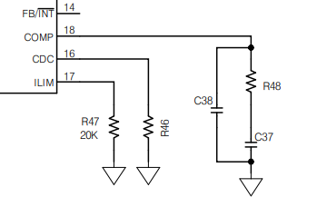

  • Hi Cho,
    Thanks for reaching out on E2E.
    Please reply with the application conditions like input voltage range, output voltage range and max output current. And I don't see any value on ILIM, CDC and COMP pins, is there any thing missing from the schematic?
    Bryce
