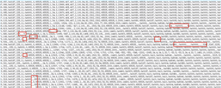

2.Use the TI EV2400 was used to capture BMS data packets separately to observe the accuracy of data packets.
Remove the 3pin line between defective BMS and DC board, use EV2400 directly to capture the BMS data packet, set the time to read the data once a second and save it to the specified file.
Capture the data is to charge and discharge the product at the same time, and find that defective products occasionally appear data errors

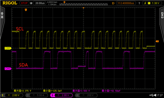

  • Dear Shirish
    Below is SDL and SCK waveform ,could u hlep to check it ?
  • It looks ok and ends with a clock stretch. Does the slightly higher "low" represent the bq4050?
  • Dear Shirish
    The slightly higher low level is the ACK signal of BQ4050.

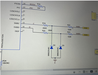

    This BQ4050 board near the power inverter , and the application is protable power station . Below is customer's schemetic and PCB ,could u help to check and give some advice ?
    This is second layer:
    This is top layer
    this is some part of the SMbus schemetic , MCU side have two 4.7K Ω pull up resistor .
  • I would first check, if disabling the interference source makes a difference in communication errors. If so, I'd check the signal quality on SMBC and SMBD. You could try using lower Ohm pull-ups, in case the total capacitance on the bus causes slow edges. And reduce the SMBC frequency.
