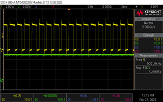

I have attached scope screen shots of the SW pin on channel one, and the SYNC input on channel two.
This first one shows the typical faulty mode of operation:
This second one shows the device working as expected:
The problem is, when the converter operates in the 80-90kHz mode, the product doesn't work due to excessive noise on the 3.3V rail.

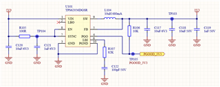

Here is the schematic, I know there is a resistor and capacitor on the LBI input that doesn't make sense, but this should not cause any problems.

    1. Please measure SYNC pin voltage on a failure part to make sure it is high and not low. What is the voltage level difference before/after cold spray?
    2. Try to remove C121, R107 and C122 which are not needed. This will rule out the possible issue from those parts. Especially C121 decoupling cap on sync pin.

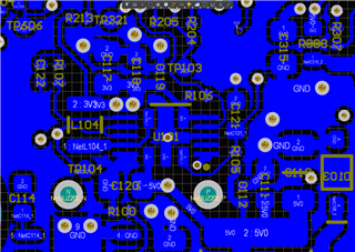

    4.  If above 4 items are not working, please send me the PCB layout file. I will review it.
    Nancy

    1) The voltage on the SYNC pin is shown on channel 2 of the scope trace, it is always 5V.
    2) I have removed C121, R107 and C122 - no change to the switching frequency.

    The PCB layout is very poor and may cause abnormal operation. Please see my schematic and layout comments as attached.
    TPS62056 Schematic_layout review.pptx
    Nancy
