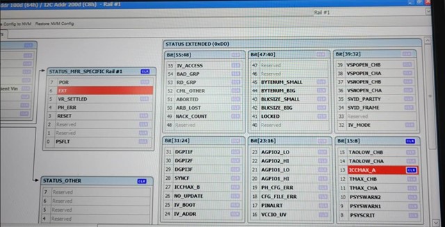

We use TPS536C7+CSD95410/ 12 phase in our application.
During start up, we find "ICCMAX_A" trigger to fault. But controller keep output voltage normally.
I want to check ICCMAX_A definition, but DDh, bit 13 is reserved in TRM.
We have measured startup current and there are no OC happened. May I know why ICCMAX_A trigger to fault?
Here is project file for your reference.
TPS536C7 @ PMBus Address 100d Project_U54_Core_Vdd_AVS_20230303.xml
