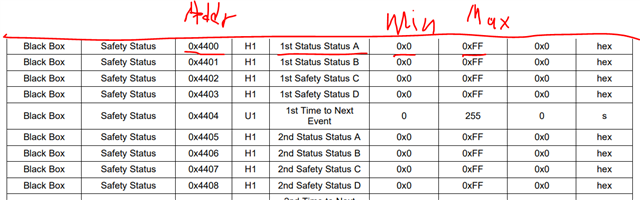

Is it possible to read all the blackbox(all the data in technical ref manual under section 14.12) data through SMBUS interface/ SBS command?

    The Section 14.12 is just showing the content of the black box, it does not show "how" to retrieve it through SMBUS.
    From table 13.1, i could see BlackboxRecorder and BlackboxRecorderReset, but none of them are related to read the content of Blackbox
    Could you teach me how to access the black box content through SMBUS? eg, register address? and the allocation of all the content?

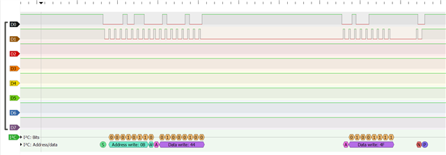

    FYI, I also try to perform DF read from CUV register, it also receives NACK right after 0x4F(CUV register DF address 0x484F) in second diagram.

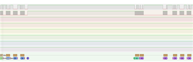

    I am trying your suggestion, However, there are still a periodic SMBUS activity after i turn off the "Scan" from BQstudio see figure 1
    Figure 1:
    Please advise how to properly turn off the entire SMBUS comms from BQstudio.

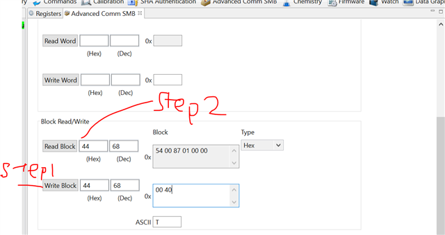

    And I would like to confirm with you is my sequence correct when using the "Advance Comm" features to read the BlackBox see figure 2
    Step 1 - in Write Block column, send block with 0x44 0x00 0x40
    Step 2-  in Read Block column, send block with 0x44 and wait for the BQ40Z50-R1 to return valid data
    And finally i would like to confirm is the very first BlackBox Data Flash address is it 0x4400?(1st Safety Status A)

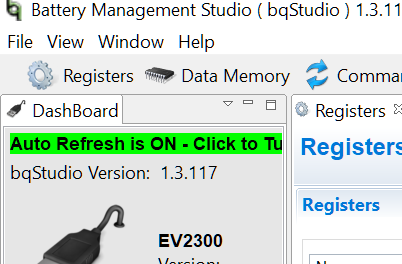

  • Click on the green text to turn off dashboard scan.

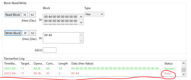

  • Hello
    Thanks for the tips to disable the "Auto Refresh" tab
    I try to use the AltManufacturerAccess() ,0x3E using BQstudio to initiate SMBUS comms, but getting an error from BQstudio See Figure 1 below
    Figure 1.

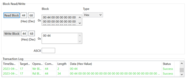

    Anyway. I use back with 0x44 ManufacturerBlockAccess(). And I manage to get a proper response with the sequence below: see Figure 2
    Figure 2

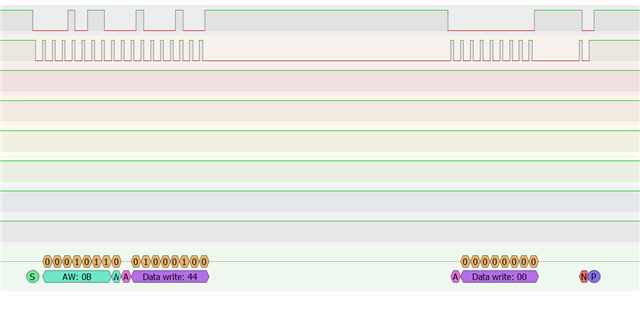

    And when i probe the SMBUS SDA/SCL line. actually, there is an additional byte(which does not show in BQstudio GUI) before the RegisterAddress(0x00 0x44) phase. see Figure 3
    Figure 3
    the 0x02(highlighted in circle) indicating the total number of bytes in the TX bytes. which explain why My very first attempt to read the BlackBox Dataflash area fail (my First attempt, the SMBUS data sequence is <DeviceAddress> 0x44 <ACK> 0x00 <NACK>  ). The NACK is initiated by the BQ40Z50R1 after seeing a 0x00.
    So same thing as when come to Block Read process thereafter. see Figure 4
    Figure 4
    The highlighted circle indicating the total number of bytes that supposed to be received in the block read process.
    As you can see that there is a total of 0x22(or 34 bytes in decimal) within the BlackBox Data Flash Area of 0x4400.
    However , from the technical reference manual its indicating only 1 byte of data within the BlackBox Data flash Area of 0x4400. See Figure 5
    Figure 5
    Could you advice and explain the discrepancy? What i really want to know is what is the byte/bits allocation/bit mapping of the black box.
