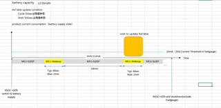

如果在如下的使用场景中,BQQ27426是否可以完成自学习,更新Qmax和Ra?
1. 电池仅用于供电电源断开的情况下使用,正常使用场景下,电池保持在不充电和不放电的场景下。
2. 在供电电源断开的情况下,电池会以0.2C放电1分钟,然后低功耗模式(10mA<dsg current threshold(15mA))维持30分钟;重复6次耗电约30mAh后关机。

  • 电池的总容量为1230mAh。我司的产品在正常使用过程中,不会断开常供电,所以电池不会进行放电,仅是保持在一个固定的容量区间。
    1. 500sec的时间可以修改,对应的参数为哪一个,请指导下?针对与这个使用场景下,为了实现自学习,是否还有其它参数需要修改?
    2. 自学习更新Ra和Qmax,是否有环境温度或是其他外部条件的限制?
    The total capacity of the battery is 1230 mAh and our products are not disconnected from the regular power supply during normal use, so the battery is not discharged and is only kept at a fixed capacity interval.
    1. Which configuration does it correspond to 500s for time conditions, please advise? Are there any other parameters that need to be modified in order to achieve self-learning for this scenario?
    2. Is there an ambient temperature or other external condition that limits the self-learning update of Ra and Qmax?

  • 我们的电池使用场景如附件所示,请确认如何配置电量计才能更新Ra Table
    并基于附件的FS文件,更新下对应参数给我们谢谢

    Our battery usage scenario is shown in the attachment. Please confirm how to configure the power meter in order to update the Ra Table.
    Please also update us with the corresponding parameters based on the attached FS file, thank you.

  • The reason why there's a 500s setting for Prime Relax Time is due to the cell voltage not immediately settling to the voltage = OCV - I.R.
    So if you configure the gauge to make cell resistance measurements sooner (e.g. in your max. 2 minute window), the gauge will calculate incorrect cell resistance. Please check with your cell vendor how fast the cell voltage settles before changing this private parameter.
