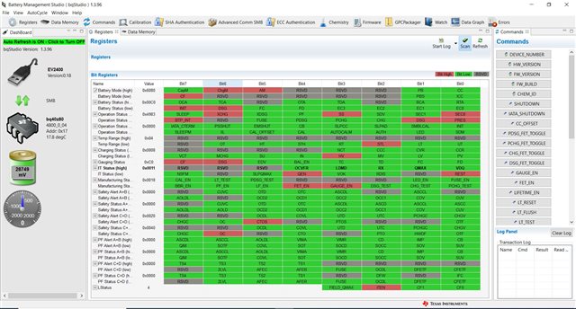

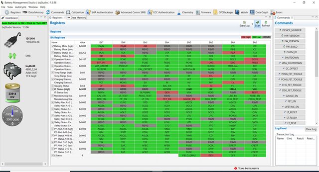

I was able to get a Golden File with a complete gas gauging cycle for CB activation.

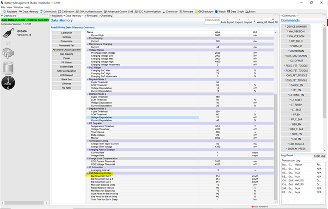

I am trying to predictably use the Charge Mode and Relax Mode cell Balancing. So far the only way I can get CB to work is by RESET and CB turns on but will shut off after about 5 minutes, most like due to the Relax Balance Interval set at 300s.
What would be the best way to get CB to activate when pack is sitting idle regardless of SOC? I can see that after RESET, the balancing time populates and with a current applied to the Pack, CB stays on which is probably CHARGE mode CB. But after taking off current off, CB goes off.
Any help would be greatly appreciated,
