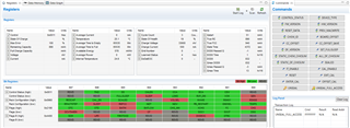

    Use Battery Management Studio (bqStudio) to make it simpler to do all of the above.
    The commands tab in bqStudio has buttons to send each of the above commands.
    The Registers tab in bqStudio can read/display and log all of the registers data.

    The manual says to click the GAUGE_EN button in the Commands plugin on the right side of the bqStudio screen.
    In Commands on the right side of our bqStudio screen there is no GAUGE_EN button.
    Please tell me how to register the GAUGE_EN button.
    The manual says to refer to the [OCVTAKEN], [VOK] and [QMax] flags of ITStatus().
    Is the [OCVTAKEN] flag Bit7 of Flags(low)?
    Is the [VOK] flag Bit1 of control Status (low)?
    The [QMax] flag cannot be found in the Registers of the bqStudio screen.
    where is this?

  • The bq34z100 doesn't use GAUGE_EN. The equivalent is IT ENABLE (command 0x0021). You only have to issue it once when the gauge is unsealed. You can check if the gauge is enabled with command LearnedStatus(). See TRM, 2.2.23. https://www.ti.com/lit/ug/sluubw5a/sluubw5a.pdf
    OCVTAKEN and VOK are in the registers that you listed.
    QMax is available in LearnedStatus().

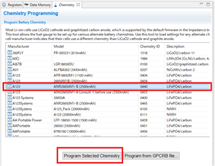

    Did you set the correct ChemID in BQStudios? You can use the GPCCHEM tool to find the correct ChemID for your battery.
    https://www.ti.com/lit/an/slva725a/slva725a.pdf

    It is simple to get a BQStudio log file. Right before you start the learning cycle, press the "Start Log" button on
    the registers screen in BQStudios. I will include a screenshot to show where this is.

    ChemID is registered as it was in the list.
