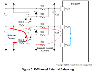

Please help check the schematic, BQ76930+BQ78350 design with 7 series (MOS high-side control, using BQ76200 driver)
The cell voltage cannot be collected, and cannot communicate; PEGOUT output voltage is 0.6V.

    In the external P-Channel FET balancing circuitry, the diodes are connected wrongly. The anode should connect to the gate of the FET and not after the gate resistor.
    Typically N-Channel FETs are used for external cell balancing as these are more robust for random cell connection. More details are explained in Section 10 Random Cell Connection – Within Limits of the bq769x0 Family Top 10 Design Considerations.
    I suggest they look at TIDA-01093 reference design for P-channel external balancing connections.
    TIDA-00792 reference design exhibits the BQ76200 high side driver and this design is the closest to the customer's design. Did they look at this design before?
    I suggest they first detailly look at these designs.
