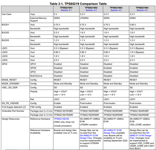

  • Hi David,
    Thanks for the quick reply. We have gone through the datasheet of TPS65219. It is said that "Nominal output voltage is configured in EEPROM"
    Also from an application note, it is providing only preset voltages from each variants of TPS65219.
    Could you please guide me how I can get voltages as per the below requirements.
    Buck 1 - 0.85V
    Buck 2 - 3.3V
    Buck 3 - Not used
    LDO1 - 1.8V
    LDO2 - Not used
    LDO 3 - 1.1V
    LDO4 - 2.5V
    Melbin

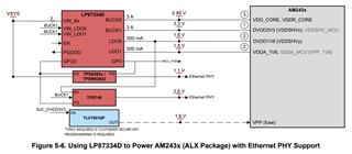

  • Hey Melbin,
    1) the TPS65219x supports user-programmable EEPROM using the USER_NVM_CMD_REG register to change the default voltages and other NVM settings such as sequencing.
    2) To request a new custom NVM, your request would need to be submitted to our marketing team for review.
    3) What package size of the AM2431 are you using? If you are using ALV, I agree TPS65219 would be a good fit. If you are using ALX, page 9 of the application note I included covers an application with similar rail voltages to yours.
