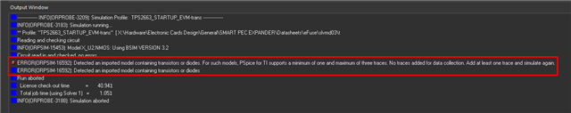

I have downloaded the PSPICE for TI and the pspice model for TPS2663, I'm encountering an error when trying to simulate the model.
I didn't do any modifications, what might be the problem?

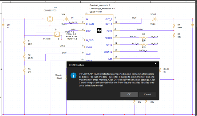

I see exactly the same problem. I can add between 1 and 3 markers to run the simulation successfully. But I don't understand this behavior because all parts in the circuit are TI ICs. So why the limitation?

I'm getting this error from pspice, it looks like there is some problem with one of the models:

Need to check with Pspice team in TI. But if you put one marker you will not see. So we have to put marker between 1 and 3.
