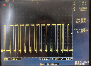

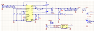

    My schematic diagram of the circuit is as follows. I found that loweside mosfets were heating badly in heavy-duty mode, and measured LO output waveforms separately.
   First of all, when the output voltage is 1.35v and the load current is 0.85A, the temperature of Q3 is 46℃ and the output waveform of LO is measured as follows, it can be seen that the opening time of Q3 is inconsistent, which is unreasonable

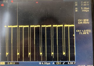

Then I adjusted the output voltage to 1.45V, the load current to 3.8A, and the temperature of Q3 rose to 100℃ within 10 seconds. At this time, the LO output waveform was measured as shown in the figure below, and it was found that the turn-on time side of lowside mosfet was longer.

  • Hi Suy,
    I'm not sure your comp values are stable with that 1mF capacitance.
    What is the ESR on that??
    The stability depends on output capacitance, ESR, and compensation values.
    Use the quickstart calculator to help with stability https://www.ti.com/tool/LM5146DESIGN-CALC
    Also be sure your layout around the low-side FET is able to sink heat.
    That is the GND polygon needs to connect to a large copper area, and then also heat spreading vias should help.
    Hope this helps,
    -Orlando

  • Hi Suy,
    The second waveform looks normal.
    The first waveform is abnormal.

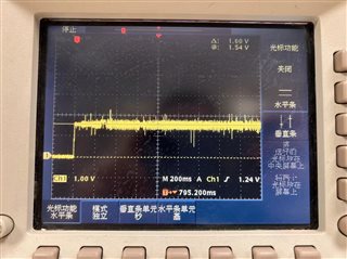

  • Hi Orlando,
       Yes, for the same group of RFB1/RFB2, when Vref is 1.2V without load, the output voltage is 2.48V, and the output voltage is 1.65V with load.
       The start-up waveform of the output voltage Vout is shown in the figure below, where Figure 1 is the waveform with no load, and Figure 2 is the start-up box with load.
