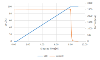

We used the BQ34Z100-G1 and completed the learning cycle. The gauge showed UpdateStatus=06, indicating that learning was complete.

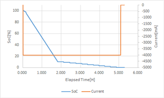

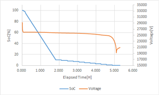

Then, we charged and discharged and evaluated the remaining power returned by the gauge. The gauge is returning a likely correct SoC when charging. However, the SoC decreases sharply during discharge, and I believe this to be incorrect.
Is it because the CHEM ID is wrong? Also, are there any other possible causes?
Charge SoC
  7041.Charge.csv
Discharge SoC
  8272.Discharge.csv
Additional information
  • BQ34Z100-G1 (FW Ver.0.16)
  • CHEM ID = 0435h
  • 8S1P LiFePO4 Battery 40Ah (So using host scaling 2. Gauge's current and capacity is indicate 1/2 of actual value.)
  • FullChargeCapacity shows correct capacity.
  • Discharge is performed at a constant current of 8000mA. Using scaling, the gauge is correctly showing 4000mA.

  • Hi them.
    I noticed below things.
    • Update Status = 06 (Learning cycle was finished)
    • Learned Status = 05 (Qmax updated. However, Ra Table not updated.)
    • Control Flag bit2 (RUP_DIS) was set during discharging.
      This indicate CHEM ID is wrong. (By TRM.)
    So I think the CHEM ID is wrong.
    Using CHEM ID 0435's deviation is 16.86% for using battery. is this deviation is large?
