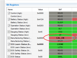

I habe a BQ34110 connected successfully to the Battery Management Studio. I can see all registers. As I have a 4-series-cell NiMH configuration with 2300 mAh, I would like to change these settings. So going to the "Data Memory" and changing the "Number of Series Cells" to 4, then clicking "Write_All" does not take it. when reading all registers this number is set back to "1".
What do I do wrong?

  • Hi Nick
    Thx for responding so quickly. I tried to send UNSEAL command and also UNSEAL_FULL_ACCESS, but neither made it work.
    According to the registers bit SEC1 = 0 and SEC0 = 1 it seems to be in full access mode.
    I attached a screenshot of the registers and the memory:
    I also try to set VEN_EN in the Pin Control Config. To do so I first set the PCTL_EN, which I could do successfully. However, when pressing on "Write to Data Memory" button simply nothing is sent to the BQ (I'm monitoring the I2C). Pressing "Write_All" and then read all back again simply resets VEN_EN again.
    So what do I do wrong?
    Eventually I want to read the voltage of the battery package. For this I have to set VEN so that my external voltage devider circuti gets active. And I have to set the number of cells.
    Kind regards, Nik

  • Hey Nik,
    The data memory parameter "Pin Control Config" is part of data flash. This value is not updating because the voltage being
    read by the gauge is less than the "Flash Update OK Voltage" value.

  • Hi Nick
    Thank for your response. You didn't point me directly to the solution but you pushed me there! So thank you very much for your patience.
    However, below the solution:
    Sending "CAL_TOGGLE" command puts the device into calibration mode, in which disables write restrictions to the flash.
    After this step, I was able to change the number of cells as well as enable VEN output pin. Now the voltage is displayed.
