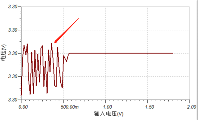

大家好,我尝试用CSD25501F3来搭建一个开关控制电路,用来控制3.3V供电的开启与关闭。3V3_control.TSC
附件是使用tina搭建的仿真电路,在进行直流传输特性仿真时发现输出结果与预期不符,请帮忙检查下是什么原因,谢谢

    Thanks for your interest in TI FETs. I tried your simulation file with a DC voltage of 1.8V instead of VG1 and the results are not as expected. I believe there is an error in the model. I will review the model in more detail and respond to you when I have more information.

  • Hello Luo Sui,
    I looked into this further and I think you made a mistake with the pin assignments when creating the TINA-TI. The pins are: 1 = drain, 2 = gate and 3 = source. I created the macro in the attached TINA-TI simulation and it works as expected.

  • Hello John
    感谢你的分析解答,很有帮助。
    我尝试用你修正了的电路,进行直流传输特性仿真,发现输出的震荡很大,这个可以通过调整这个电路的哪些元器件参数来优化吗
  • Hi Luo,
    Try adding some resistance on the output side of your circuit to GND. I added a 1kΩ resistor and increased to 100kΩ and the circuit seems to work OK. I think what you are seeing is noise and/or leakage thru the FET. Let me know if you still have issues.
