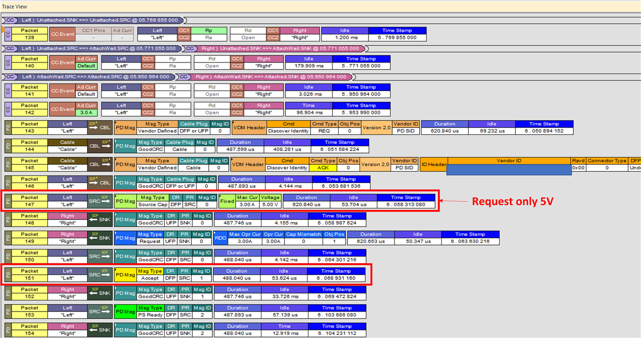

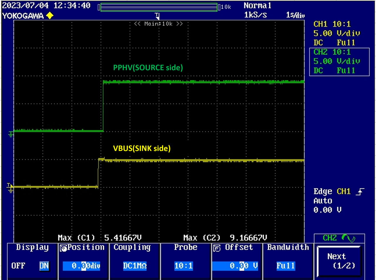

However, they have used the tool to make the necessary settings and are not getting the desired output 27W(9V).
From the voltage waveform it looks like the negotiation is failing.

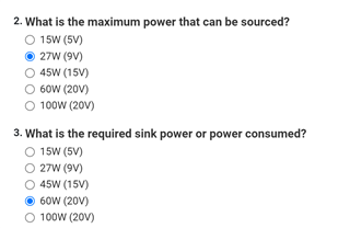

This EVM can achieve 27W/9V output at the source, right?
I would like you to check if there are any mistakes in the BIN file, but I cannot attach the file.
