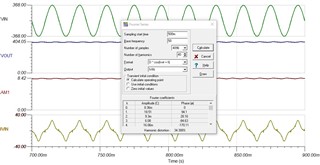

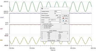

    I get the following results for the minimum (Umin=190V --> sqrt(2)*190V = 269V) and maximum input voltage (Umax=260V -->
    sqrt(2)*260V = 368V) at f=50Hz.
    //picture 269V                                                                                            //picture 368V
    But now I still have two questions:
    1. Question:
    When analyzing the Fourier Series, I get for the minimum input voltage (269V) a value for Harmonic distortion of 5.86% but
     for the maximum input voltage a value of 34.4%.
    Why is this value so high? Is this value ok or is there still an error in the system?
    with PF = cos(theta)/sqrt(1+THD) thus results in a value of PF=0.97 for the minimum input voltage and PF=0.86 for the maximum input voltage.

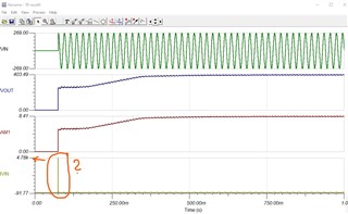

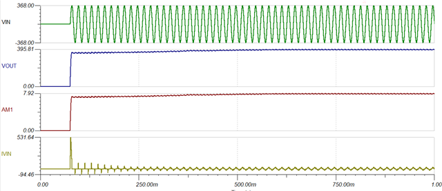

    2. Question:
    Could you explain again why such a high peak input current occurs? Is this ok, or do I have an error here as well?

  • The spike in current is ok. This is because of the initial conditions of the model. Ideally in a practical circuit there will be a precharge phase where the boost voltage is close to 325V and then the boost stage pumps it to 400V. Also remember there are a lot of approximations in this model for both the converter and boost stage.
    I think you should stick close to the excel/MATHCAD values. If NCT is too low, there may be high power loss in sense resistor and insufficient LM. If too high, there could be excessive LLK and Cd. The THD values are expected to low at high input line voltage and high at low input voltage at full load. I do not expect these values to match board results. These are only tentative numbers which show the trend but please stick with the excel/MATHCAD tool values

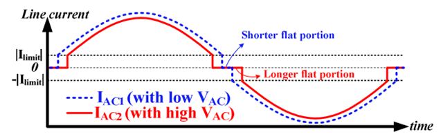

    1. The boost inductor stores enough energy during the inductor charging phase normally. During the inductor discharging (off time) phase, the total capacitance, charges up to the required voltage, which is the output voltage Vout plus the turn-on voltage of the output diode. Once the diode is turned on, the energy stored in the inductor is delivered to the output.
    2. When the line voltage VAC is near the zero-crossings, the inductor can still store the energy during the inductor charging phase, but the energy is too low to charge the switch node up to the required voltage during the inductor discharging phase. As a result, the diode will not be turned on and the energy will be confined in the tank circuit consisting of Csw and Lboost and will be discontinuous for an interval until the absolute value of the line voltage lager than the voltage residual voltage on the bulk capacitor after diode rectifier.
    3. Thus, the diode of the bridge rectifier can’t be turned on and the flat portion in the line input current IAC happens. This distortion is called “crossover distortion”, which increases the number of the total harmonics in the IAC greatly. In other words, the THD becomes serious.
    4. At high line voltage on time is reduced drastically and the amount of energy stored in boost inductance is less and this effect becomes more when compared to low input line voltage.
    5. The crossover distortion may also be deteriorated if the input line rms voltage increases because the output power is fixed and thus the line current becomes lower. It results in large flat portion as depicted in Fig below. The Ilimit is the required current which can charge the switch node up to the required voltage.
