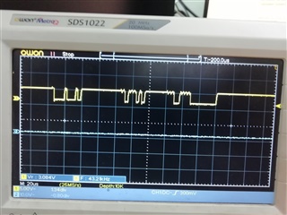

    2. For the photos of the signal, can you use an digital logic analyzer to view the signal so we can see what is being sent as well as whether an ACK bit is received.

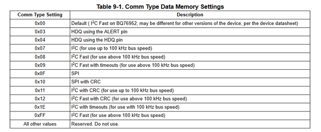

    3. Is your device using CRC checks for transmission? The BQ7695202 by default has CRC enabled it that would change the signals you send and receive if your MCU isn't expecting the CRC to be there.

    2. No sir I do not have logic analyzer except oscilloscope.
    3. I was unware about that BQ7695202 by default has CRC enabled and in program I have disable the same. this may be the reason , I will try the same and  revert you back for same perspective.
    # sir now I able to the to read the all data but i can't able to write anything in BQ7xxx

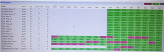

    Can you confirm that your device is entering CONFIG_UPDATE mode by checking the 0x12 Battery Status()[CFGUPDATE] flag? In order to enter CONFIG_UPDATE mode, your device needs be in FULLACCESS mode. There is a chance your device is in SEALED or UNSEALED mode which allows reads but not writes. This can be verified by viewing 0x12 Battery Status()[SEC1, SEC0] and seeing if they are [0,1], meaning the device is in FULLACCESS. For more information on this setting, you can view section 8.1 in the TRM.
    Asher Nederveld
  • HELLO SIR,
    I CHECKED THAT BIT Status()[SEC1, SEC0]  WHICH THAT ALREADY SET AS  [0,1] (WHICH IS 8 AND 9 BIT)  STILL I CANT ABLE TO ASSCESS THE  WRITE  OPERATION.
    ONE THING MORE I WANT TO MENTION HERE IS THAT , AS SHOW HERE TO TWO CODE AVALIABLE IN TI SITE FOR THE SAME (OLDER AND NEW ONE ) BY NEW ONE I CANT ABLE TO READ ANY THING AND BY OLDER ONE , SAME WAS THE ISSUSE WITH THAT BUT ONE PLUS POINT WAS THAT ONLY I WAS ABLE TO RAED  THE "STACK VOLTAGE"  ONELY AND BY USING THE SAME FUNCTION AFTER SOME CHANGES (BECAUSE ITS WORKING FINE SO I USED THAT SAME FUNCTION TO READ THE OTHER DATA (EG.TEMP,CELL1-CELL16) )
    I REALLY DON'T KNOW WHAT GOING ON AND I REQUESTED TO PLEASE IF YOU HAVE  PROVIDE ME SIMPLE CODE TO READ AND WRITE OPERATION EITHER THEN PLEASE GUIDE ME BY STEPS;

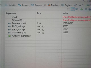

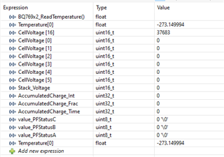

    THIS OUTPUT RESULT , WHEN I DEBUGE WITH NEW(ATTACHED BELOW) CODE. BY THIS I CANT ABLE TO READ THE TS1 EVEN,
    AND I RECHECK EVERY THING TWISE BUT NO RESULT I GOTTED,

    1)  AS PER TEC.DATASHEET OF BQXXXX , WE CAN USE THE I2C AT 100KHZ AND 400KHZ , IF I WANT TO SET THE BQ I2C AT 200KHZ CAN I OR NOT?
    2) AS YOU EARLY SAID THAT , IN BQ CRC IS BYDEFAULT ENABLE THEN IF I WANT TO DISABLE THE SAME SAME HOW I CAN DO THE SAME?

  • Dear Arjun,
    1. The device is only meant to do 100kHz and 400kHz I2C.
    2. You would need to modify the register at Settings:Configuration:Comm Type to select which communication mode you want. I've attached the options below. For more information, view section 9.1 in the Technical Reference Manual
    3. If you wish to see whether a COV or CUV occurred, you can read the values in the Safety Status A Register, bits 2 and 3. If you wish to determine whether your write has successfully occurred, you would just need to read to the COV/CUV Threshold register under Protections:CUV/COV:Threshold.
    4. To put your device into SEALED mode, you can set the Security:Settings:Security Settings[SEAL] bit so that it enters SEALED mode on power-up, or you can send the 0x0030 SEAL() subcommand to put it into SEALED mode.
    5. I'm not 100% sure what you are asking on this question, but when you disable CRC, it should also apply to commands and subcommands.

    This is what we getting during SCD..
    Apart from this, I also seen that, during short circuit discharging the BQ7xx getting slightly hot and its going in Over internal temperature fault. after this BQxx being reset again and again (WD bits gets high all the time).
    Q2. My last question is that dose BQ76952 core have kalman filter to estimate the accurate SoC, If not then is the SoC we are getting is accurate how can I understand this concept or if you have document related to the same then please share.
    thanks and regards
  • Dear Arjun,
    Looking at your .gg files, I'm not sure your current calculations are correct. You're respective SCD thresholds are 7 and 10 for 40A and 60A. Given your current sense resistor setup is 8 resistors in parallel of 10mOhms of resistance, this gives total resistance of 1.25mOhm. A 7 for an SCD threshold means a total of 150mV is seen across the SRP and SRN pins. With your resistance right now, you'd need roughly 120A to trigger an OCD, not 40A. Likewise, a 10 implies 250mV across the SRP and SRN pins, correlating to a necessary current of 200A to trigger.
    Can you confirm your device reaches 200A during a short circuit event? If it doesn't, the fault wouldn't trigger, allowing the device to become unpowered as the voltage of the pack falls with the short circuit. With not enough power, it could be possible that a RAM failure occurs if the memory is no longer getting power.
    For your second question, the chip does not feature a Kalman filter built into it to determine SoC. It does provide all the necessary voltages, charges, and currents to determine SoC though. If you wish, a stack-level gauge like the BQ34Z100-G1 can be used in conjunction with the BQ769x2 to provide SoC calcs.
    Asher Nederveld
  • Hello sir,
    Sorry, I forget to mention that things:-
    For 60A -->  shunt 10 miliohm (8 Nos.)  = Req = 1.25 miliohm
    For 40A --> shunt 4 miliohm (4 Nos.)  = Req = 1 miliohm
    At .gg files
    For 60A   -->  SCD = 10 (250 mV)  = 200A
    For 40A   -->  SCD =  7 (150 mV)  = 150A
    One more thing is that, during short circuit discharging the BQ76952 get completely reset and REG1 voltage become zero due to that I2C connection become lost for 1-2 sec and then BQ7xx get stucked in loop and watchdog bits become high -forever
  • Dear Arjun,
    Does SCD trigger when you run the 60A SCD test? The device shouldn't be heating up that much in one short circuit, especially if room temp is ~30C. Have you tried swapping the BQ769x2 chip to see if the same problem persists across multiple devices?
    For the complete reset, is it clearing all registers or just restarting the hardware? Generally, if the SCD isn't triggering and the device continues to pull high current and the pack voltage drops, the chip might stop receiving power.
    I'll try running your .gg file in the morning to see if I can see the same results you are seeing on an EVM.
    Asher Nederveld
  • Hello Sir,
    1. Yes, SCD gets triggered and have tried the different BQ76x2 device but the same problem is occurred.
    2. its just resting the hardware or power supply due to that the I2C connection become lost and the changes we made after OTP in the same  that become also reset due to the lost of power supply on REG1
    ok sir, let me know what is the cause behind that !
  • Dear Arjun,
    Besides the sense resistor change, is there any changes in the hardware of the set-up? While testing the .gg file on the EVM, I was able to trigger an SCD and have the FETs turn off.
    One thing that would be good to check is that all your DSG FETs are still in good condition. It's possible that the FETs might have gotten damaged some how and is acting as a short so the whether or not the DSG FET is on, current can flow. If that is the case, a short circuit triggering SCD is software wouldn't be able to turn the gate off. This would lead to the chip not receiving power and therefore causing a reset.
    Likewise, what are you using for the SCD test? Typically its best to use a battery that doesn't have a current limit like a power supply to make sure you can reach 200A. I noticed you delay is ~450uA so it might be good to try shortening the time delay if you are trying to use a power supply for the test. This likely won't fix anything, but it would be good to test.
    One last question, why did you vary the resistances from FET gate to source on the power path? Typical applications use 10Mohm resistors, but you seem to use both 1Mohm and 470K resistors.
    Asher Nederveld
