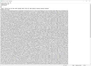

  • Hi Rahil,
    Still no luck.
    I started fresh by extracting the TPSF12C1_PSpice.zip that you uploaded in this thread into a brand new isolated folder.  Next I copied the TPSF12C1-Q1.LIB that you attached in your post over the .lib file already in the folder just to make sure.  I loaded the "tpsf12c1_ac.opj" project file in PSpice, as normal, and it still doesn't show the STAB port in the model text, or run the AC simulation without the mismatch error.
    It does say a message window (attached snapshot) that it has updated parts, not sure if that has anything to do with it or not.
    Peter

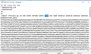

  • Hi Peter,
    I'm opening the file on my side and it runs perfectly. Can you please delete the folder you made, re-extract the TPSF12C1_PSpice.zip into an isolated folder, open the TPSF12C1_AC folder, open the TPSF12C1-Q1.lib file and send me a scree shot?
    Rahil
  • Ok did that, attaching the snapshot.  Hopefully you can read it, but the STAB port is definitely there.

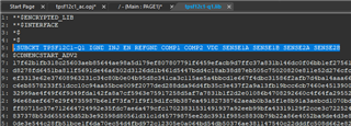

  • Have discovered that when I open the project with PSpice that .lib file suddenly doesn't have the STAB pin any more.  I have "A/B"'d this a couple of times.  Made brand-new folders, re-extracted, etc...
    Every time PSpice loads up, it puts up that indicator window that it's updated the models to the latest from TI..is it possible that it's changing it automatically due to that?  Is there a way I can disable that auto-update and try it?
    Peter
  • To update: I have tried pasting the original .lib file (the same one you uploaded here as well) over the .lib file, in the folder *after* loading the project and letting PSpice establish, and now the simulation runs.  So it seems to have something to do with loading the project that it overwrites the .lib file with the original pinout for the TPSF12C1, with what it thinks it should be.  Any idea what could be causing this?

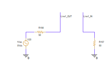

  • Hi Peter,
    You need to do it remove the inductor and capacitor and short the STAB pin to COMP2. If you're doing insertion loss create a circuit like this:
    Use the formula DB(V(LINE1_IN)/V(LINE1_OUT)) to graph it.
    Rahil
  • Hi Rahil, thanks for your insight, I've tried this and it appears to be working now, and the SENSE pins functional to complete the loop.
    Cheers,
