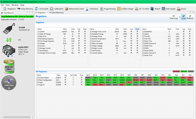

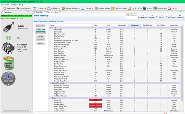

The battery is fully charged, after Qmax update, update status jumps directly to 05 with no wait is reset:
Could you help check this case? Thanks.

Hi Steven,
Thank you for the support.
This condition is show up when the impedance is turned on, would it affect impedance tracking learning?
Thanks and regards,
Cherry
What do you mean for "impedance is turned on", I am seeing in the log file, the QEN is set during entire test. Since it is expected, it should not affect learning
