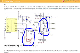

    As you referred the link, the BJT based current buffer is used for Gate Drive and Miller circuit highlighted with blue color circle, given below for your quick reference.

    A2. To implement the same CLAMPI pin for both the SiC MOSFETs you would have to short both the GATE terminals together which might cause issues like ringing propagation, etc. Therefore, it is recommended to use a separate FET for clamping the another GATE terminal of one of the FETs. An external miller clamp can be used if 4A isn't enough as well as mentioned in the image below:
