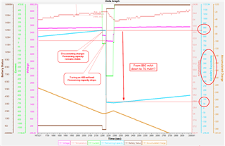

  • Meanwhile it seems like I have more or less successfully set up the fuel gauge. However, "Remaining Capacity" remains a little mystery.When start to charge empty batteris, it starts to increase "Remaining Capacity". However, it suddenly jumps up (gets sync) to Full Charge Capacity. The same thing happens when starting to discharge, it emidiately jumps down to a very low value (almost empty), and from there it decreases correctly by the amount of discharge.
    Now, the first is probably because it determined fully charged batteries, causing it to sync RC with FCC (that's because CSYNC is set). However, I'm unable to understand the aprupt loss of charge when starting to discharge...?

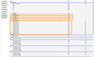

    I already have set the flag "FIXED_EDV0".
    I also have defined the fixed EDV 0 to 2 and all the DOD values:

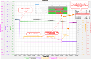

    However, as soon as I start to pull load from the battery the "remaining capacity" droppes from 2200 mAh down to 153 mAh, which doesn't make sence to me so far. However, I am unable to find any settings/description that the remaining capacity is recalculated as soon as I start to make us of the battey.
    So you may help me out here?
    Below I show the process when (on the left) just finished charging. The FG stated FC, thus reset "Remaining Charge" to 2200 mAh. However, as soon as I start the load of about 100 mA, the battery status immediatelly states "low charge" (??) and the remaining charge is set to about 153 mAh. The voltage is still on a level of about 1.37 V per cell.
    So what causes the remaining capacity to drop?
    Best regards
    Nik

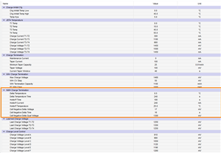

    I would check if charge termination parameters are set correctly in Operation Config A and "Charger Control"
  • Hi Shirish,
    Here ar the settings in Operation Config A
    and the Charge Control Settings
    Do you see anything suspecious?
  • Hello Nik,
    Since i do not know the characteristics of your battery, i cannot comment on it. Make sure that charge termination is detected by the gauge at the right time. That is key to determining Full charge capacity which in turn will affect remaining capacity calculations

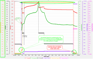

    So far, "Accumulated charge" is kind of useable, whereas "Remaining capacity" has a huge jump downwards, as soon as I start to discharge.
