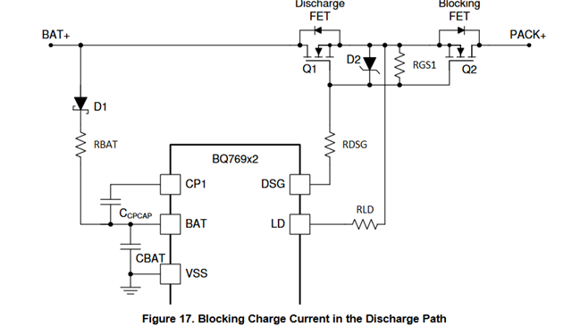

We're using the BQ76952 in a parallel FET configuration (we have Settings:FET:FET Options - SFET set to 0), and we're noticing strange behavior regarding the CFETOFF and DFETOFF pins.  We're controlling these two pins via a microcontroller and both pins are configured to their alt functions (Settings:Configuration:CFETOFF/DFETOFF Pin Config both set to 0x2).  Individually, these pins both function properly.  If only one of the pins is high, the corresponding FET will indeed be off.  However, in our firmware logic, when switching between charge or discharge mode, all of the charge/discharge circuitry is turned off before enabling the other side, so there will be a brief period where both CFETOFF and DFETOFF are high.  However, this doesn't seem to be the case, and instead when CFETOFF and DFETOFF are both high, the discharge FET seems to stay on.  I understand that in a series configuration, this would be expected behavior in order to protect the discharge FET, but why is this happening in parallel mode?

    I looked over you schematic and couldn't find anything wrong with it that would produce the results you are seeing. Normally a 22nF capacitor is put between REGIN and BAT- to improve the performance, but that wouldn't cause the issues you are seeing. However, the data you provided has a large amount of oddities with the CP1 and CHG pins. From the data, the battery voltage is 36V and the charger voltage is 48V. However, the CP1 voltage when DFETOFF is enabled is far too high. Its only meant to produce 11V above the BAT pin at most. Even assuming that while charging that the BAT voltage equals the charger voltage, it still falls 7V short. Could you try measuring the BAT pin voltage in these three scenarios as well? If you have DDSG and DCHG enabled to mimic the DSG and CHG signals, it would also be good to see if those pins are reacting properly to DFETOFF and CFETOFF. If they turn off when DFETOFF and CFETOFF are sent, then it will be a hardware issue of some sort pulling the DSG and CHG pins high.
    Based on your data, it seems like there is a correlation between disabling the CHG FET (during both off) and then seeing realistic values for the DSG  and CHG pins versus when it's only DFETOFF. This makes me think that there might be leakage current somewhere.

    The other FET in the charge path isn't connected to CFETOFF, the rest of the path components get controlled by our microcontroller, so the charge voltage gets blocked much further down the chain.  The discharge path also has an additional blocker between the BQ and the system power bus, and we're able to measure some of the battery voltage on one side of that blocker (only because the BQ DFET 44V) and the charger voltage on the other side.
  • Dear Nathan,
    Where are you connected LD_PACK node on your schematic? Typical parallel FET applications will split the two nodes as LD is used for detecting a load on discharge while PACK is used to detect a charger. Since your two pins are sharing the same node, that might cause leakage issues as the DSG pin is discharged towards the LD pin and not to GND to protect it during turn-off. This is described in section 16.5 of the datasheet. If LD is connected to the charger instead of the discharge, it might cause the leakage issue. I've attached captures from the Parallel Paths with the BQ769x2 Battery Monitor app note to show typical usage of the LD and PACK pins on a parallel application. Could you try adjusting your LD pin to see if this makes a difference?
    Asher Nederveld
    Thanks for pointing this out, disconnecting our LD and PACK pins resolved the issue.
