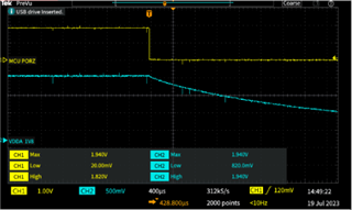

We are using PMIC TPS6521908 in our design.
We are observing some differences in the Power down sequence of PMIC between various DC boards, while trying to capture waveforms as part of DVT.

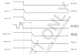

The ramp down of the voltages w.r.t Reset happens simultaneously and not after 10ms(refer snapshot below from TPS6521908_TRM). We understand that discharge duraon depends on Vout, Cout and load. But we want to know why we are seeing this difference between boards. Also is the timing duration specified in trm, a maximum limit? Pls let us know.
I have pasted here below ,captures for a couple of voltage rails for your reference.
board 1: (10 ms delay is observed between reset and all power rails(except for 1.1V) during power down sequence as per TRM)
board2: (No delay is observed between reset and all power rails during power down sequence) - not as per TRM
Additionally, we want to know how to measure this power down sequence of GPO2 w.r.t VSYS.  Is this VSYS at pmic input or the output of power switch?
(Please note :- To measure power down sequence we have connected a tactile switch at the PMIC enable pin and pressing it to disable the pmic. )
Kindly provide your inputs on the above two queries

    Thank You for using E2E! Based on the information provided in the previous message, the board #1 executes an orderly power-down sequence matching the TPS6521908 TRM and board #2 executes an immediate power-down with all rails turning OFF simultaneously. There are four key items that affect the power-down sequence: the voltage level on the pre-regulator that supplies VSYS, the external capacitance/load, the BYPASS_RAILS_DISCHARGED_CHECK register setting and any faults. Since the problem in your design seems to be more related to the sequencing order, then we could suspect the voltage on VSYS goes below the UVLO threshold before the PMIC completes the power-down sequence or the PMIC is detecting a fault during power-down.
    Could you add the VSYS voltage to the scope captures in your previous message? Do you see any interrupt in the interrupt source register (INT_SOURCE, address 0x2B)?
    To read the interrupt register you would have to pull the Enable pin back to high so PMIC can transition to Active state.

    Thanks for your patience! An immediate or orderly power-down does not affect the PMIC but might have consequences on the reliability of the processor. PMIC executes a sequenced power-down as long as the voltage on VSYS is present until the power-down sequence is complete. I would recommend checking with the processor team about the consequences (if any) of not following the expected power-down sequence from the AM62. Here is the link to the processor forum:
