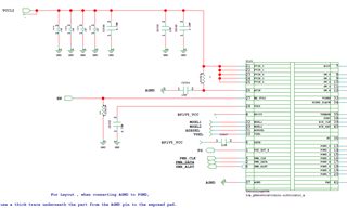

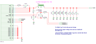

please review the design, changes are made as per the comments from my last query.

Hi Nikhil,
I see the added 0Ω resistor in series with the BOOT pin and C2548, which looks good. If you made any changes to the pin programming of VSEL, MSEL1, MSEL2, or ADRSEL that you would like me to review please share a screenshot of that part of the schematic and I can give my feedback.
Dani
Hi Dani,
I haven't changed the VSEL, MSEL1, MSEL2, or ADRSEL selection, it's as per you recommendation.
does it have any significance on the order of R and C in RC snubber?
thanks for reviewing the design.
Nikhil
Hi Nikhil,
The order of the resistor and capacitor in an RC snubber does not change the functionality of the snubber. Many designers prefer to place the resistor to ground since the resistor is the element that dissipates the most power, and therefore that power can be dissipated to ground. However the snubber functionality is not affected one way or the other.
Dani
