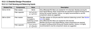

Hi Expert,
How 616 can support the hot plug for BMS applicaiton and what kind of ations does 616 take to secure a better hot plug result?

Hi David,
Yes, we have recommendations to address hot-plug events. You can find our suggestions for this in the BQ79616-Q1 datasheet , below.
We also have more options listed in section 10.2.1.2.7.2.
As the above information states, we recommend adding resistors/capacitors of certain values to help ensure hotplug performance.
Hope this helped!
