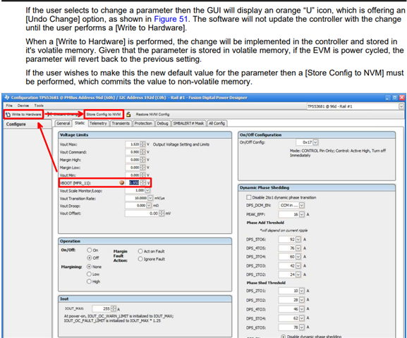

I try to solve this issue and use a method from another topic that provided that "store Config to NVM before save the project file" , but the checksum still would be changed after programmed.

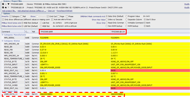

Checksum of Code file : F229DFA
After programming and checksum of the board became: F229DFB
Compare differences between F229DFA/ F229DFB , the difference is 0xBB User_Data_11. (Fig 1)

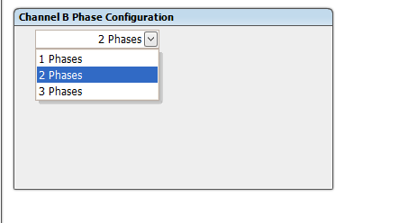

I also compare differences between those two files, and the variable is "channel B phase Configuration " from set up "1phase to 2phase". (Fig 2)

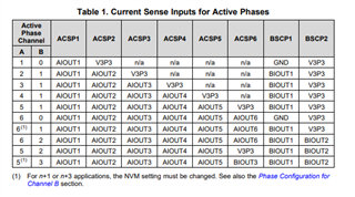

Due to our design is 2phase+1phase in actual board, and this change is from the original code file set up "1 phase" become "2 phase".
I was thinking.... Is this root caused by mismatch between the settings and the application?
Will the code have a mechanism to make mandatory changes based on the actual board status? In my point of view, the imported code should have the highest control.
