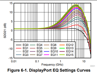

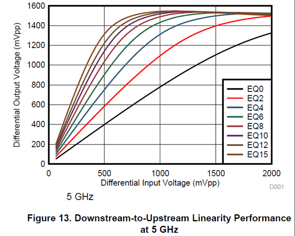

1. In the picture below, what's the difference between EQ0~EQ15? What is the meaning of the coordinates? (i.e. Differential input/output voltage)

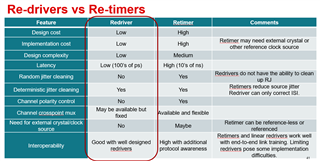

3. For Linear redriver,  what is its selling point? which features are vital to automotive customers? What is the advantage of our redriver in the market?

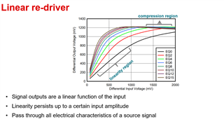

    For question 1, please see below. Differential input voltage is the input signal into the re-driver while differential output voltage is the signal out of the re-driver. The linearity range is the area which the output signal amplitude is almost a one-to-one ratio to the input signal amplitude. When using linear re-driver, you want to make sure the input signal amplitude is within the linearity range of the re-driver for best performance.
    EQ0-15 is the AC gain compensation which can be shown in this plot. You use EQ to compensate for the channel insertion loss, which reduces the ISI jitter. But as you can see from the above plot, higher EQ would also result in smaller linearity range.

    3. For re-driver benefit, please refer to the table below

    Thanks for your quick reply and detailed explanation. I have an extra question: As shown below, you said "the linearity range is the area which the output signal amplitude is almost a one-to-one ratio to the input signal amplitude." Now that the ratio is 1:1, the signal is not enhanced, how does our redriver compensate the cable loss?  Within my understanding, the equalization (compensation) means the output differential signal is 12dB (for instance) larger than the input differential signal. What is the definition for linear equalization?

    You are thinking signal amplitude amplification (DC gain), but this is not the equalization purpose. The purpose of equalization is,
    –Selectively boosts high-frequency data
    –Compensates for the media’s high frequency roll-off
    –Includes a high-pass filter that ideally has a frequency response exactly opposite to the media insertion loss that the equalizer is attempting to compensate
    So linear equalization is to maintain the original input signal characteristic as long as the input signal is within the linear re-driver linearity range and also provide compensation to the high frequency portion of the data.
