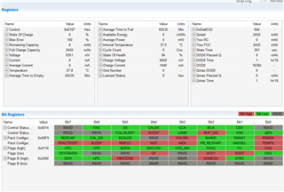

I'm working on the implementation of a gas gauge BQ34Z100-G1 on a hardware product.
We use an NiMH pack battery of 7 cells 2600mA 1.2V
After (Initial state battery Discharge) Relax -> Full Charge -> Discharge -> ReIax log cycle, I get the following Chem ID:
Chem ID max DOD error, % Max R deviation, ratio
6117 6.21 0.23
6107 7.95 0.71
I configured my gas gauge with the chem ID 6107 which is from the same manufacturer that my pack battery.
From that, i started a learn cycle (IT_Enabled) from relaxed battery full discharge with attached configuration
After full charge and relax period > 2h, I didn't get a learned status = 5
I attached the data log of the chemistry identification 18082023_NiMH.zip, the report file and exported dataflash configuration of the gauge.
For information I use the BQZ firmware version 2_02.
