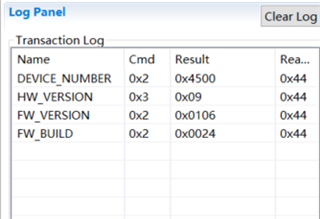

I have a battery with high rate discharge. In bq40z50,how do I optimize the  Prime Relax Time, Sec. Relax Time, Resistance Parameter Filter, Resistance Parameter Filter, Dis Relax Time Min and OCV Wait Time
What scheme do you suggest?
    Please provide BQZ file. Also FW version and FW build.
    With this info I can inform the memory addresses to write to.
    If using BQStudio, please get the info from here.

  • Thanks for your reply,
    The picture following is device_number...
    In regard to BQZ file,does it mean gg file and srec file?I can't load on them directly here.Could you give me a email? I will send them to you.
  • Hi Lion,
    Prime relax time -> address = 0x4740. Units in seconds. Data length = 2
    Sec relax time -> address = 0x4742. Units in seconds. Data length = 1
    Resistance parameter filter -> address = 0x4754. Data length = 2
    Dis relax time min -> address = 0x4788. Units in seconds. Data length = 2
    OCV wait time -> address = 0x4743. Units in seconds. Data length = 2
