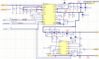

I am using the BQ28Z610 but not as a self-contained battery pack. Rather, a 2-cell lipo battery will generally be supplied by the user and plugged into the BQ28Z610.
There will also be a USB-C input for charging of the battery (although users may just plug in a fully charged battery instead, so USB-C charging is optional).
Hence, i want the BQ28Z610 to power up as soon as the charged battery is attached, turn on the MOSFETs and supply voltage to VSYS of the charger.
I note that the TI evaluation board has a switch from VBAT TO VPACK to temporarily allow the user to connect VPACK TO VBAT to bring the device out of shutdown.
i don't want that. There will not be an on/off switch.
If the battery is present, the device will be on.

In the TI example circuits there is a diode from VPACK to the PACK terminal for powering the BQ28Z610. However, i do not think that is sufficient to power up the BQ28Z610 when a new, charged battery is attached. Indeed, the TI evaluation board has a switch that can be pressed that shorts VBAT to VPACK to bring the device out of shutdown.
Is it acceptable to also connect a battery directly from the positive battery terminal to the PACK terminal of the BQ28Z610?
The intention is the the BQ28Z610 is powered whether or not USB power is applied or just the battery voltage?

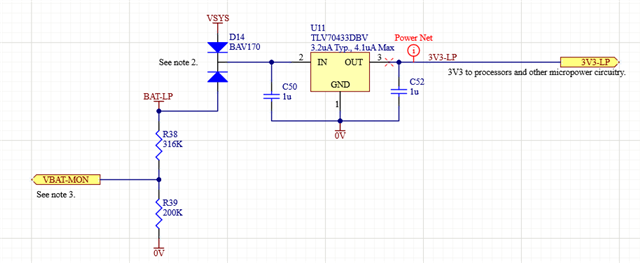

The processor could (possibly) put the fuel gauge into shutdown for minimum current consumption although I suppose that would make it lose its ability to keep an accurate battery capacity. The processor could also wake up the BQ28Z610.
There will be some other circuitry attached to VSYS, which I would ideally like to disable to reduce power.
Question: Is there any way that can be turned off other than shutting down the BQ28Z610?
I don't think the BQ25883 can have its VSYS O/P disabled but i thought I'd ask while here.

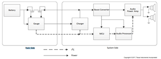

    Also, I wanted to clarify that the BQ28z610 is PACK side implementation, not system side. Meaning the battery should be attached at all times.

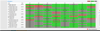

    FYI, I have a discharged battery attached. I haven’t programmed anything yet. But when I apply the charger voltage and hence voltage to the pack terminal, the MOSFETS are both turned off.
    Is this normal behaviour? I might have expected the charge FET to turn on. This is early days so haven’t done much probing eg to see if the charge FET turns on momentarily. ie should the charge FET at least attempt to turn on by default or do I need to program the device in some way first?I am certain this will be in the data sheet but you are sure to know the answer to that!

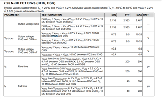

    The charge FET should be ON if FET_EN is set. See below
    In case the DSG FET is off, as soon as the gauge detects a current greater than the body diode protection threshold current, it will turn ON the DSG FET.
    Also, I forgot to mention that the charge pump uses PACK pin to drive DSG FET gate voltage. Your design might cause issues with charge pump. Leakage current in the DSG pin can affect the charge pump.

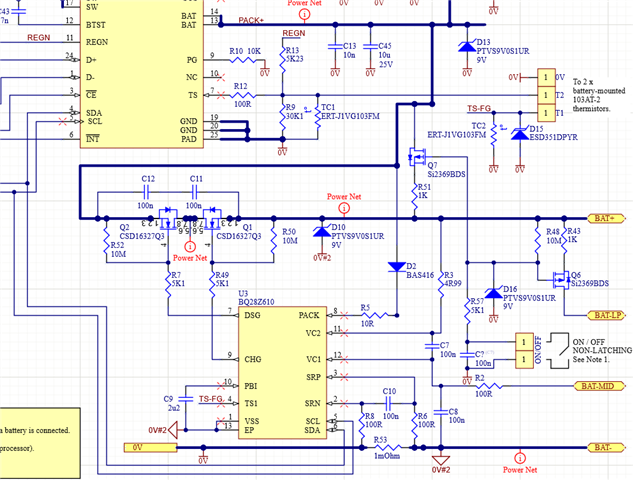

    I have considered your suggestions and I think the following will be a little better and would like your thoughts:
    Capacitor C? (not yet designated) across the switch will temporarily turn on Q7 for a second or so, when the battery is attached.
    I may need to adjust the RC time constant which as shown is approx 10M x 0.1uF = 1s.
    This will switch the battery voltage to the PACK+ net and therefore to the PACK pin.
    (The switch is purely there for my debugging and will not be in the final circuit as the application does not have an on/off switch).
    This circuit also turns on Q6 which powers a low power mcu (the mcu is also powered by VSYS if present). Hence, at power up the mcu can drive the i2c bus and power up the BQ28Z610.

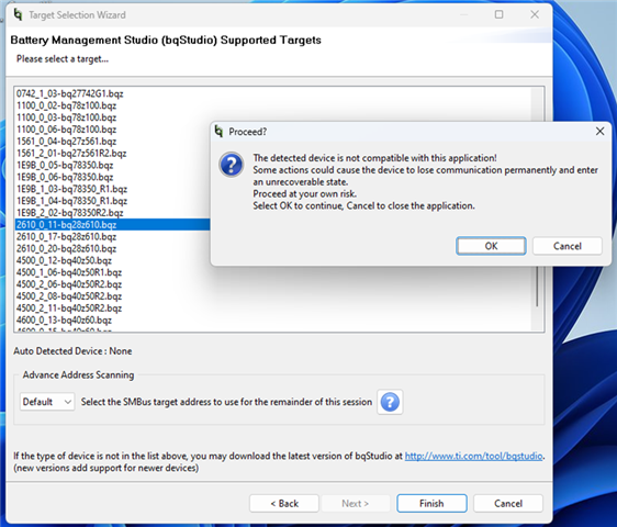

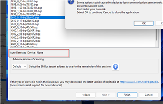

    However, I am having an issue with the battery software. I get the following error:

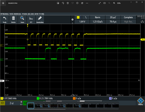

    FYI, in case it helps, when I start the software, the first I2C transaction (repeated 3 times) is:
    Also, how does one know which BQ28Z610.bqz target to choose?
  • Hi Derek,
    When the device is awake, it will display the target file BQZ, see below.
    Try waking up the device before opening BQStudio. Apply a voltage at the PACK pin.

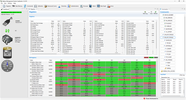

    However at power up, I apply voltage to the PACK pin (for now by keeping the switch closed) but both mosfets are turned off. I can manually turn them on and off using the commands at the right hand side of the BQstudio software.
    So, comms is fine. I could of course turn the mosfets on manually using I2C commands, but I was expecting the discharge mosfet to turn on by default.
    The register values are are shown below. Battery voltage is measured at 6.91V (measured using a meter) and recorded as 6.891V by the device.
    I am wondering if the 1K resistor R51 could be having an effect but I think I recall seeing a similar resistor in a TI circuit (although I may be wrong there).
    In any case, I am still wondering why the discharge fet is off when I apply a battery voltage and then start I2C comms.

    I believe the issue is FET_EN being 0 in the Manufacturing Status Register. See below.
    When FET_EN = 1, the FETs are Firmware driven autonomously. When FET_EN = 0, these are considered to be in TEST mode.
    Jose Couso
  • Thanks Jose,
    I have programmed FET_EN =1 and that works. Thank you.
    I take it the default is for FET_EN = 0  so that the mosfets are off and one must program the device to enable them?

    Yes, by default FET_EN is off. This is so that you can test the FETs are turning ON and OFF properly. By writing 1 to FET_EN, it should be saved in data flash regardless if the gauge is power cycled. You can always toggle FET_EN.
