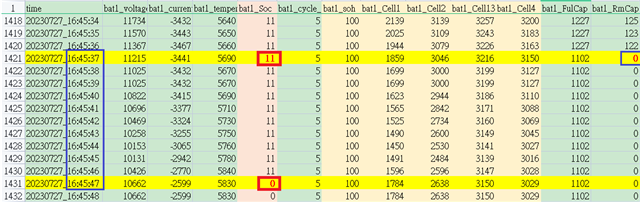

The customer design with BQ40Z50, the problem is after the remaining capacity is updated to 0, the SOC has not changed to 0. Wait about 10 seconds then the SOC is updated to 0.
Attached the data.
The reason why Remaining Capacity is updated to 0 (Term Min Cell V), but I don’t know why SOC is not updated to 0 synchronously.

  • Hi Jose
    Thanks for your reply.
    What does 5690 mean?
    A: 5690 = 56.90 Celsius
    The RSOC_HOLD is not set.
    Attached is our final product's gg file and drone BMS log.
    CR-BMS-G61 BMS_IC V07.gg.csvBMS_Log_20230727_162247.xlsx

  • Hi Jose
    Thanks for your help.
    They have found the reason. To allow Drone to fly for an additional period of time, the system set a Delay of 10 seconds to display 0%.

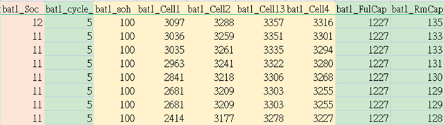

    Another query is the voltage of the cell is significantly different from the other three battery cells, why is SOC still 11%?
    Waiting for your reply.
    Star
  • Hi Star,
    The SOC reporting 11 when the cell-1 is 2.6V could be related to the delay of 10seconds.
    It looks like the gauge should report 0% based on configurations. Cell_term =1 in the settings.
    Another reason could be that the end of discharge voltage falls under the flat region. I will need to know the matched ChemID. You can provide the srec, or they can read ChemID (see below)
    As for the voltage imbalance seen above, is cell balancing enabled? Doing a sanity check in the schematic will also help identify this.
